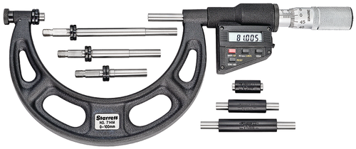

Electronic Interchangeable Anvil Outside Micrometer
Electronic or Mechanical

Range (in)
0-4"
Range (mm)
0-101mm
Resolution (in)
.00005"
Resolution (mm)
0.001mm
Accuracy (in)
+/- .0001"
Accuracy (mm)
+/- .003mm

Starrett no-glare satin chrome finish on thimble and sleeve
Large, easy-to-read .275 (7mm) high contrast LCD digital readout
Extremely hard and stable one-piece spindle
Auto Off after 20 minutes of nonuse
Inch/millimeter conversion on English versions
Smooth friction thimble for uniform pressure
Measurement HOLD button
Zero at any position

The Starrett 714.1 Series Electronic Interchangeable Anvil Micrometer with Standard Inch Graduations on Shell and Thimble features a 0-4" and 0-101mm measuring range, and .00005" resolution. 0-4" Range, .0001" Res., Friction Thimble, Lock Nut.
The direct replacement is W714.1AAFLZ.
