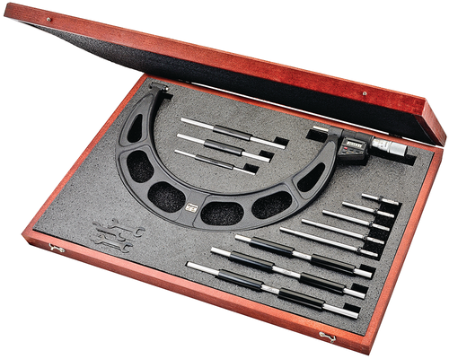

The Starrett 714.1 Series Electronic Interchangeable Anvil Micrometer with Standard Inch Graduations on Shell and Thimble features a 20-24" and 508-609mm measuring range, and .0001" resolution. Friction Thimble, Lock Nut.

- Electronic Interchangeable Anvil Outside Micrometer
- Electronic or Mechanical
- Electronic
- Range (in)
- 20-24"
- Range (mm)
- 508-609mm
- Resolution (in)
- .00005"
- Resolution (mm)
- 0.001mm
- Accuracy (in)
- +/- .00035"
- Accuracy (mm)
- +/- .008mm
- Lock Nut Type
- Knurled Ring Type
- Output
- Cabled Only
- Graduations (in)
- .001"
- Thimble Graduations
- English
- 13 Attribute:
- Thimble Type
- 13 Spec:
- Friction
- 14 Attribute:
- Case Type
- 14 Spec:
- Wood case
- 15 Attribute:
- Anvil/Spindle Material
- 15 Spec:
- Steel
- 16 Attribute:
- Anvil Type
- 16 Spec:
- Flat
- 17 Attribute:
- Spindle Type
- 17 Spec:
- Flat
- 18 Attribute:
- Product Type
- 18 Spec:
- Micrometer - Interchangeable Anvil
- Accuracy (in):
- +/- .00035"
- Accuracy (mm):
- +/-.008mm
- Anvil Type:
- Flat
- Brochure 1:
- https://s3.us-west-2.amazonaws.com/catsy.833/starrett-electronic-precision-hand-tools-bulletin-590.pdf#page=6
- 0049659728002
- 72800
- Electronic
- Starrett no-glare satin chrome finish on thimble and sleeve
- Large, easy-to-read .275 (7mm) high contrast LCD digital readout
- Auto Off after 20 minutes of nonuse
- Inch/millimeter conversion on English versions
- Smooth friction thimble for uniform pressure
- Measurement HOLD button
- Zero at any position
- Feature 09:
- Retain and return to true zero reading
- Feature 10:
- Spindle lock
- Feature 11:
- Data Output
- Feature 12:
- Resolution: .00005" (0.001mm)
- Feature 13:
- Accuracy +/-.0001 (+/-.002mm)
- Feature 14:
- PRESET button to install any reading at any position
- Feature 15:
- Ability to install minimum and maximum limits
- Graduations (in):
- .001"
- Lock Nut Type:
- Knurled Ring Type
- Micrometer Type:
