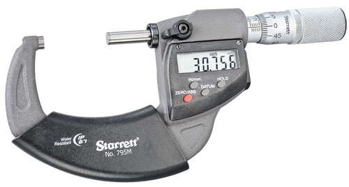

IP67 protection against coolants, water, chips, dust and dirt (ranges 0-4"/0-100mm only)
Starrett no-glare satin chrome finish on thimble and sleeve
Micro-lapped carbide measuring faces
Large, easy-to-read .275 (7mm) high contrast LCD digital readout
Balanced and tapered frame
Extremely hard and stable one-piece spindle
Auto Off after 20 minutes of nonuse
Inch/millimeter conversion on English versions
Feature 09:
Smooth friction thimble for uniform pressure
Feature 10:
Measurement HOLD button
Feature 11:
Zero at any position
Feature 12:
Retain and return to true zero reading
Feature 13:
Spindle lock
Feature 14:
Data Output
Feature 15:
Resolution: .00005" (0.001mm)
Feature 16:
Accuracy +/-.0001 (=+/-.002mm)
Feature 17:
PRESET button to install any reading at any position
Feature 18:
Ability to install minimum and maximum limits
Lock Nut Type:
Lever
Micrometer Type:
Electronic Outside
https://s3.us-west-2.amazonaws.com/catsy.833/733.1MEXFLZ-50e72462cUSp1.tif
https://s3.us-west-2.amazonaws.com/catsy.833/733.1MEXFLZ-50e72462cUSz1.tif

25-50mm Range, 0.001mm Resolution, IP67 Outside Electronic Micrometer with Friction Thimble, Carbide Anvil, and SPC Output
The Starrett 733.1 Electronic Micrometer with Output is a full-featured precision measuring tool built with customary Starrett quality and workmanship. It includes output capability for data transmission. The 733.1 series includes a large, easy-to-read, high-contrast LCD digital readout for clear readings. With its automatic OFF functionality, smooth friction thimble for uniform pressure, and balanced frame design, Starrett products provide comfortable and accurate measuring. Its no-glare satin chrome finish minimizes annoying surface glare under bright lights indoors. Starrett electronic micrometers guarantee a precise measurement at every position each and every time.
