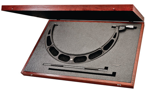

The Starrett 733.1 Electronic Micrometer with Output is a full-featured precision measuring tool built with customary Starrett quality and workmanship. It includes output capability for data transmission. The 733.1 series includes a large, easy-to-read, high-contrast LCD digital readout for clear readings. With its automatic OFF functionality, smooth friction thimble for uniform pressure, and balanced frame design, Starrett products provide comfortable and accurate measuring. Its no-glare satin chrome finish minimizes annoying surface glare under bright lights indoors. Starrett electronic micrometers guarantee a precise measurement at every position each and every time.

- Electronic
- Starrett no-glare satin chrome finish on thimble and sleeve
- Large, easy-to-read .275 (7mm) high contrast LCD digital readout
- Balanced and tapered frame
- Auto Off after 20 minutes of nonuse
- Inch/millimeter conversion on English versions
- Smooth friction thimble for uniform pressure
- Feature 09:
- Measurement HOLD button
- Feature 10:
- Zero at any position
- Feature 11:
- Retain and return to true zero reading
- Feature 12:
- Spindle lock
- Feature 13:
- Data Output
- Feature 14:
- Resolution: .00005" (0.001mm)
- Feature 15:
- Accuracy +/-.0001 (=+/-.002mm)
- Feature 16:
- PRESET button to install any reading at any position
- Feature 17:
- Ability to install minimum and maximum limits
