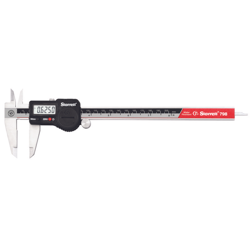

The Starrett Electronic Caliper features a large, easy-to-read, high contrast LCD readout. It includes IP67 protection against coolants, water, chips, dust and dirt often found in machine shop environments. Its induction type linear encoder system and inch/millimeter metric conversion makes Starrett precision measuring tools the right choice for any job. This model features 0-200mm (0-8") measuring range and 0.01mm (.0005") resolution. 0-200mm (0-8"), with Output, in Fitted Plastic Case 0-8" (0-200mm), with Output, in Fitted Plastic Case
798B-8/200 IP67 Electronic Caliper

- Resolution (in):
- .0005"
- Resolution (mm):
- 0.01mm
- 049659125238
- 0049659125238
- $473.00
- $473.00
- 798
- TOOLS.HARDWARE TOOLS (NON-DISCOUNTABLE).
- https://s3.us-west-2.amazonaws.com/catsy.833/Starrett-Catalog-33-Section-02-Slide-Calipers.pdf
- 2
- Slide Calipers
- Electronic Calipers
- Range (in)
- Whitepaper 1:
- https://s3.us-west-2.amazonaws.com/catsy.833/Data-Collection-in-Manufacturing.pdf
- 9017.30.4000
- Output:
- Cabled Only
- China
- 0-8"
- Range (mm)
- 0-200mm
- Resolution (in)
- .0005"
- Resolution (mm)
- 0.01mm
- Accuracy (in)
- 0-8”: (+/- .001”)
- Accuracy (mm)
- 0 -100mm: (+/- 0.02mm) >100mm - 200mm: (+/- 0.03mm)
- Output
- Cabled Only
- SLC Certification
- Optional Add-On
- Inside Jaw Depth (in)
- 3/4"
- Inside Jaw Depth (mm)
- 19mm
- Outside Jaw Depth (in)
- 1-7/8"
- Outside Jaw Depth (mm)
- 47.6mm

- IP67 protection against coolants, water, chips, dust and dirt often found in machine shop environments
- Fine adjustment
- Hardened stainless steel measuring surfaces
- Induction type linear encoder system
- RS232 output
- Heavy-duty bar and slide
- Slide lock
- Feature 09:
- One 3-volt battery for over one year of normal usage
- Feature 10:
- In/mm conversion
- Feature 11:
- Zero at any position
- Feature 12:
- Auto-Off after 30 minutes
- Feature 13:
- Reactivation of display with no loss of position
- Feature 14:
- Works well with Starrett DataSure Wireless Data Collection Systems
