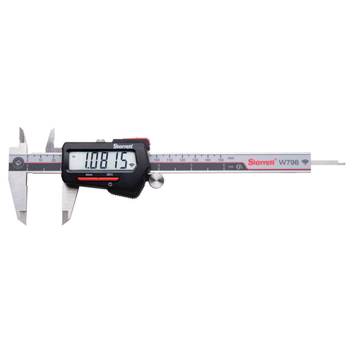

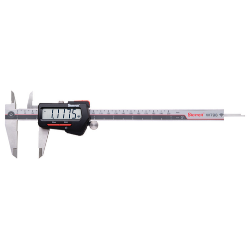

The Starrett W798B Wireless Caliper features a large, easy-to-read, high contrast LCD readout. It includes IP67 protection against coolants, water, chips, dust and dirt often found in machine shop environments. Its induction type linear encoder system and inch/millimeter metric conversion makes Starrett precision measuring tools the right choice for any job. This model features 0-8" (0-200mm ) measuring range and .0005" (0.01mm) resolution. With Wireless Output, in Fitted Plastic Case Free Mobile Application To use the wireless feature, download the free Datasure Mobile application from i-Tunes (iOS) or Play Store (Android devices). Your wireless Starrett tool will communicate to your mobile device from a distance of up to 30 feet. Send the data with the click of a button or your Starrett wireless gage. It is automatically collected on your device, and can be emailed. air-dropped or texted. The datasure app also provides lots of features and functions such as digital read out (DRO), formulas, unit conversions (SAE/mm), ability to name tools (connect 5 to 8 tools depending your on device capability), name parts being measured, set min/max levels, use device as a remote display, and much more. Download the brochure or give us a call for more details!
