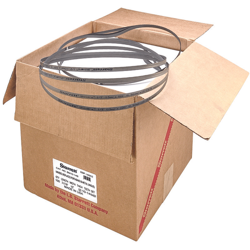

3FT 8 7/8" PORTABAND BIMETAL PB 10 TPI
BM10 Univerz PORTABAND, 3' 8-7/8" (114cm) in Length, 1/2" Wide x .020" Thick (13 x 0.50mm) with a 10 pitch and straight (zero) rake

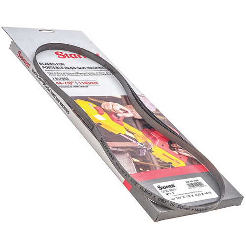

3 Ft. 8-7/8 In. Univerz™ Portaband - 1/2" Width, .020" Thickness, 10 TPI. The Univerz portable band saw blade utilizes Starrett's exclusive bi-metal unique saw technology for faster cutting and longer blade life. Blades are welded, ready to go to work in convenient lengths to fit popular portable machines. PLEASE NOTE: 3-pack sleeve. Must order in multiples of 3. Prices are for Each blade.
