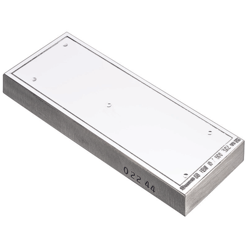

Starrett blocks can be used to test Brinell or Vickers scales. They are available in steel, brass and aluminum. Each block is serialized, with a certificate detailing the environmental conditions used to test the block. Actual readings are given, with the averages of these readings: min. reading, max reading and a repeatability figure. The blocks are calibrated according to ASTM E-18 standards, ANSI (NCSL) Z540-1, (ISO) 10012-1, ISO/IEC 17025 and Mil-std 45662A. Brinell Block 3000kg Low Mil-std 45662A.
PT05258 3000kg Low Brinell Test Block

- Starrett blocks can be used to test Bench Top Hardness Testers
- Each block is serialized, with a certificate detailing the environmental conditions used to test the block
- Actual readings are given, with the averages of these readings: min. reading, max reading and a repeatability figure
- The blocks are calibrated according to ASTM E-18 standards, ANSI (NCSL) Z540-1, (ISO) 10012-1, ISO/IEC 17025 and Mil-std 45662A.
- Hardness test blocks are designed to be used on one side only
- Indents should be more than .010" from the centers of two indents or no closer to the block's edge than .040"
