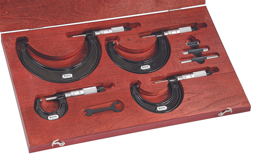

Starrett quality at competitive price
Accurate, rugged, and easy to use
ratchet stop, lock nut, and standards included
Micro-lapped measuring faces
Starrett No-glare satin chrome finish on thimble and sleeve minimizes annoying surface glare under bright lights and resists rust
Attractive, protective case, which keep micrometers and standards together, readily accessible
Balanced frame and thimble design ensure easy handling

This set of 4 T441.1 micrometers includes delivers 0-4” measurement range with .0001" graduations. The T444.1 Outside Micrometers have a heat-insulator on the frame to help reduce temperature-related expansion or contraction. The spindle and anvil have flat measuring faces and are carbide-tipped for wear resistance. A spindle lock helps provide secure locking of the measurement. Features a combination ratchet and speeder for uniform pressure and quicker adjustment. Recommended for mechanics, automotive service and machine shops, toolrooms, inspection departments and wherever gaging involves a wide range of measurements.
