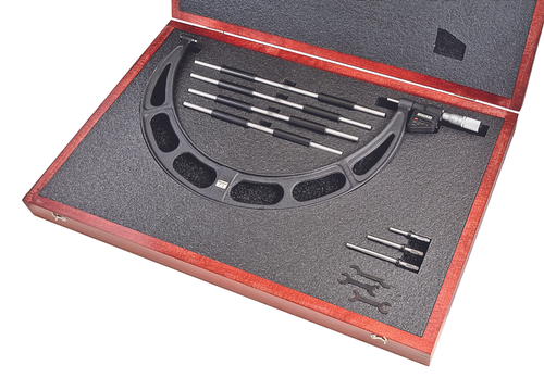

The Starrett W714.1 Series Wireless Interchangeable Anvil Micrometer with Standard Inch Graduations on Shell and Thimble features a 6-12" (150-300mm) measuring range, and .00005" (.0001mm) resolution, Friction Thimble, and Lock Nut. Free Mobile Application To use the wireless feature, download the free Datasure Mobile application from i-Tunes (iOS) or Play Store (Android devices). Your wireless Starrett tool will communicate to your mobile device from a distance of up to 30 feet. Send the data with the click of a button or your Starrett wireless gage. It is automatically collected on your device, and can be emailed. air-dropped or texted. The datasure app also provides lots of features and functions such as digital read out (DRO), formulas, unit conversions (SAE/mm), ability to name tools (connect 5 to 8 tools depending your on device capability), name parts being measured, set min/max levels, use device as a remote display, and much more. Download the brochure or give us a call for more details!
