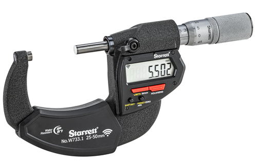

W733.1MEXFL-25 Wireless Electronic Micrometer
Micrometer
Range (in):
0-1"
Range (mm):
0-25mm
0-25mm Range, 0.001mm Resolution, Wireless IP67 Outside Electronic Micrometer with Friction Thimble and Carbide Anvil
Thimble Graduations:
English
Thimble Type:
Friction
1.4
6.4
3.3
$1035.00
12200301
0.95
https://www.starrett.com/UM-W733.1
733.1 Electronic Digital Micrometers
Case Type:
Plastic
Display Type:
LCD
Max. Range (in):
Max. Range (mm):
25
Min. Range (in):
Min. Range (mm):
https://s3.us-west-2.amazonaws.com/catsy.833/W733.1MEXFL-25e60582cUSp1.tif
Spindle Type:
Flat
Anvil/Spindle Material:
Carbide Face
Bulletin 590 - PMT - Electronic Precision Hand Tools Brochure|Bulletin 591 - PMT - DataSure Brochure
17 Attribute:
Case Type
17 Spec:
Plastic
Optional Add-On
Includes:
Micrometer, charging cable, wrench, case.
Standards Included:
None
Accessories Included:
Wrench, standard, case.
The Starrett 733.1 Electronic Micrometer with Output is a full-featured precision measuring tool built with customary Starrett quality and workmanship. It includes output capability for data transmission. The 733.1 series includes a large, easy-to-read, high-contrast LCD digital readout for clear readings. With its automatic OFF functionality, smooth friction thimble for uniform pressure, and balanced frame design, Starrett products provide comfortable and accurate measuring. Its no-glare satin chrome finish minimizes annoying surface glare under bright lights indoors. Starrett electronic micrometers guarantee a precise measurement at every position each and every time.
This wireless model is equipped to send data with the push of a button, and features a rechargeable battery.
