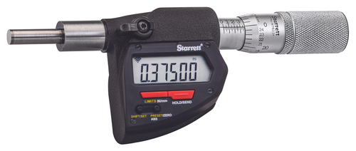

The Starrett W788.1 Wireless Micrometer is a full-featured precision measuring tool built with customary Starrett quality and workmanship. The W788 is ideal for measuring the wall thickness of parts such as solid and split bearings, tubing, sleeves, collars, rings, various cylinders, and also measuring from the inside of a hole to an edge. The W788 includes wireless output capability for data transmission. Special features include a large, easy-to-read, high-contrast LCD digital readout for clear readings. Its no-glare satin chrome finish minimizes annoying surface glare under bright lights indoors or filters out UV light. Advanced sleeve design with staggered lines and distinct figures for precise and easy readability. Starrett electronic micrometers guarantee a precise measurement at every position each and every time. 0-1" (0-25mm) Range, Carbide Anvil & Spindle, without Case. Free Mobile Application To use the wireless feature, download the free Datasure Mobile application from App Store (iOS) or Play Store (Android devices). Your wireless Starrett tool will communicate to your mobile device from a distance of up to 30 feet. Send the data with the click of a button or your Starrett wireless gage. It is automatically collected on your device, and can be emailed. air-dropped or texted. The datasure app also provides lots of features and functions such as digital read out (DRO), formulas, unit conversions (SAE/mm), ability to name tools (connect 5 to 8 tools depending your on device capability), name parts being measured, set min/max levels, use device as a remote display, and much more. Download the brochure or give us a call for more details!
