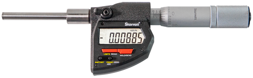

Wireless operating distance up to 9 meters (30 feet)
Rechargeable battery port
IP67 protection against coolants, water, chips, dust and dirt (ranges 0-4"/0-100mm only)
Starrett no-glare satin chrome finish on thimble and sleeve
Micro-lapped carbide measuring faces
Large, easy-to-read .275 (7mm) high contrast LCD digital readout
Balanced and tapered frame
Extremely hard and stable one-piece spindle
Feature 09:
Auto Off after 20 minutes of nonuse
Feature 10:
Inch/millimeter conversion on English versions
Feature 11:
Smooth friction thimble for uniform pressure
Feature 12:
Measurement HOLD button
Feature 13:
Zero at any position
Feature 14:
Retain and return to true zero reading
Feature 15:
Spindle lock
Feature 16:
Ability to install minimum and maximum limits
Feature 17:
Resolution: .00005" (0.001mm)

1-2" Range, .00005" Resolution, Wireless IP67 Outside Electronic Micrometer with Friction Thimble and Carbide Anvil
Thimble Graduations:
English
Thimble Type:
Friction
1.4
7.6
3.4
$1019.00
12200085
iv10X94dFhw
1.15
https://www.starrett.com/UM-W733.1
733.1 Electronic Digital Micrometers
Case Type:
Plastic
Display Type:
LCD
Max. Range (in):
Max. Range (mm):
50.8
Min. Range (in):
Min. Range (mm):
25.4
https://s3.us-west-2.amazonaws.com/catsy.833/W733.1XFLZ-2e60586cUSp1.tif
Spindle Type:
Flat
Anvil/Spindle Material:
Carbide Face
Dimension Type:
Inch and Metric
Bulletin 590 - PMT - Electronic Precision Hand Tools Brochure|Bulletin 591 - PMT - DataSure Brochure
Optional Add-On
Includes:
Micrometer, charging cable, wrench, standard, case.
Standards Included:
1"
Accessories Included:
Wrench, standard, case.
The Starrett 733.1 Electronic Micrometer with Output is a full-featured precision measuring tool built with customary Starrett quality and workmanship. It includes output capability for data transmission. The 733.1 series includes a large, easy-to-read, high-contrast LCD digital readout for clear readings. With its automatic OFF functionality, smooth friction thimble for uniform pressure, and balanced frame design, Starrett products provide comfortable and accurate measuring. Its no-glare satin chrome finish minimizes annoying surface glare under bright lights indoors. Starrett electronic micrometers guarantee a precise measurement at every position each and every time.
This wireless model is equipped to send data with the push of a button, and features a rechargeable battery.
