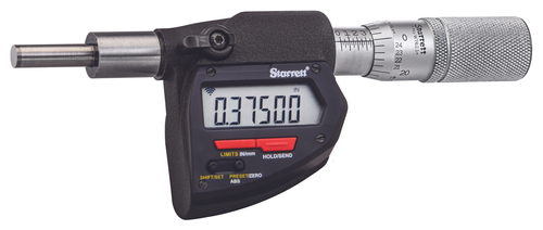

The Starrett W762.1XFL-2Wireless Micrometer Head with Standard Millimeter Graduations on Shell and Thimble includes 0-2"/0-50mm range, friction thimble, lock nut, and carbide face. Featuring large digital readout that is easy to read and reduces errors. Conventional inch or millimeter graduations are standard. Heads are easy to handle with smooth friction thimble for uniform pressure. 0-2" (0-50mm)Range, Friction Thimble, Lock Nut, Carbide Face. Free Mobile Application To use the wireless feature, download the free Datasure Mobile application from App Store (iOS) or Play Store (Android devices). Your wireless Starrett tool will communicate to your mobile device from a distance of up to 30 feet. Send the data with the click of a button or your Starrett wireless gage. It is automatically collected on your device, and can be emailed. air-dropped or texted. The datasure app also provides lots of features and functions such as digital read out (DRO), formulas, unit conversions (SAE/mm), ability to name tools (connect 5 to 8 tools depending your on device capability), name parts being measured, set min/max levels, use device as a remote display, and much more. Download the brochure or give us a call for more details!
