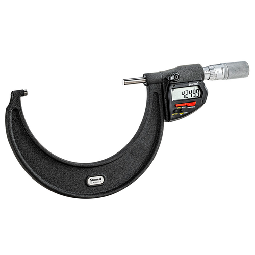

The Starrett 733.1 Electronic Micrometer with Output is a full-featured precision measuring tool built with customary Starrett quality and workmanship. It includes output capability for data transmission. The 733.1 series includes a large, easy-to-read, high-contrast LCD digital readout for clear readings. With its automatic OFF functionality, smooth friction thimble for uniform pressure, and balanced frame design, Starrett products provide comfortable and accurate measuring. Its no-glare satin chrome finish minimizes annoying surface glare under bright lights indoors. Starrett electronic micrometers guarantee a precise measurement at every position each and every time.

- Wireless operating distance up to 9 meters (30 feet)
- Rechargeable battery port
- IP67 protection against coolants, water, chips, dust and dirt (ranges 0-4"/0-100mm only)
- Starrett no-glare satin chrome finish on thimble and sleeve
- Large, easy-to-read .275 (7mm) high contrast LCD digital readout
- Balanced and tapered frame
- Feature 09:
- Auto Off after 20 minutes of nonuse
- Feature 10:
- Inch/millimeter conversion on English versions
- Feature 11:
- Smooth friction thimble for uniform pressure
- Feature 12:
- Measurement HOLD button
- Feature 13:
- Zero at any position
- Feature 14:
- Retain and return to true zero reading
- Feature 15:
- Spindle lock
- Feature 16:
- Ability to install minimum and maximum limits
- Feature 17:
- Resolution: .00005" (0.001mm)
- Feature 18:
- Accuracy +/-.0001 (=+/-.002mm)
- Feature 19:
- PRESET button to install any reading at any position
