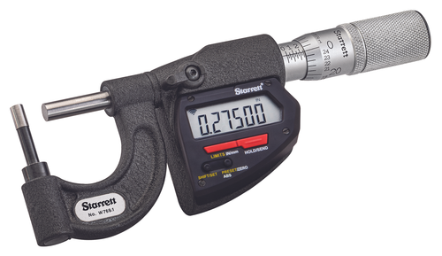

The Starrett W769.1 Series Wireless Tube Micrometer is used for measuring the wall thickness of tubing and other materials that have cylindrical walls. This tool is also used for measuring from hole-to-edge. Built with customary Starrett quality and workmanship, the 769 series includes a large, easy-to-read, high-contrast LCD digital readout for clear readings. Its no-glare satin chrome finish minimizes annoying surface glare under bright lights indoors or filters out UV light. This model features 0.00005"in and 0.001mm resolution and 0-1"in and 0-25mm measuring range. Starrett electronic micrometers guarantee a precise measurement at every position each and every time. 0-1" (0-25mm) Range with Output, Carbide Spindle.
Free Mobile Application
To use the wireless feature, download the free Datasure Mobile application from i-Tunes (iOS) or Play Store (Android devices). Your wireless Starrett tool will communicate to your mobile device from a distance of up to 30 feet. Send the data with the click of a button or your Starrett wireless gage. It is automatically collected on your device, and can be emailed. air-dropped or texted. The datasure app also provides lots of features and functions such as digital read out (DRO), formulas, unit conversions (SAE/mm), ability to name tools (connect 5 to 8 tools depending your on device capability), name parts being measured, set min/max levels, use device as a remote display, and much more. Download the brochure or give us a call for more details!

- Wireless operating distance up to 9 meters (30 feet)
- Rechargeable battery port
- Starrett no-glare satin chrome finish on thimble and sleeve
- Large, easy-to-read .275 (7mm) high contrast LCD digital readout
- Auto Off after 20 minutes of nonuse
- Inch/millimeter conversion on English versions
- Smooth friction thimble for uniform pressure
- Feature 09:
- Measurement HOLD button
- Feature 10:
- Zero at any position
- Feature 11:
- Retain and return to true zero reading
- Feature 12:
- Spindle lock
- Feature 13:
- Ability to install minimum and maximum limits
- Feature 14:
- Resolution: .00005" (0.001mm)
- Feature 15:
- Accuracy +/-.0001 (+/-.002mm)
- Feature 16:
- PRESET button to install any reading at any position
