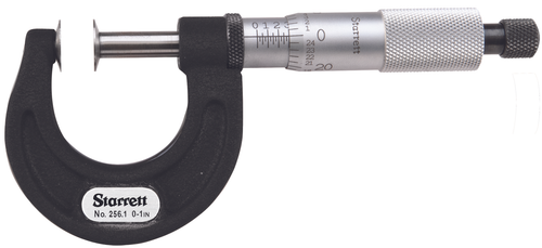

Starrett satin chrome-no glare-resists rust
Advanced sleeve design with staggered lines and distinct figures for precise and easy readability
Quick-reading figures every thousandth numbered
Balanced frame and thimble design ensure easy handling and better readability
Ring type lock nut for quick and sure locking
The combination ratchet and speeder for uniform pressure and quicker adjustment on all sizes
Gracefully tapered frame for use in narrow slots and tight places
Anvil and spindle discs are 1/2” (12.7mm) diameter tapering to .015” (0.4mm) edge thickness making it possible to enter narrow grooves and recesses
Feature 09:
Extremely hard and stable one-piece spindle (the heart of our accuracy)
Feature 10:
Quick and easy adjustment
Feature 11:
This tool is accurate to +/-.00015” or +/-0.003mm measuring over the whole surface and +/-.0002” or +/-0.004mm measuring on the edges

The Starrett 256.1M Disc-Type Micrometer is used to measure the thickness of work sections such as ribs, lands, fins, cutting edges on form tools, and chordal thickness of gear teeth. 1-2" Range, .001" Grad, Ratchet Stop, Lock Nut.
The direct replacement is 486P-2.
