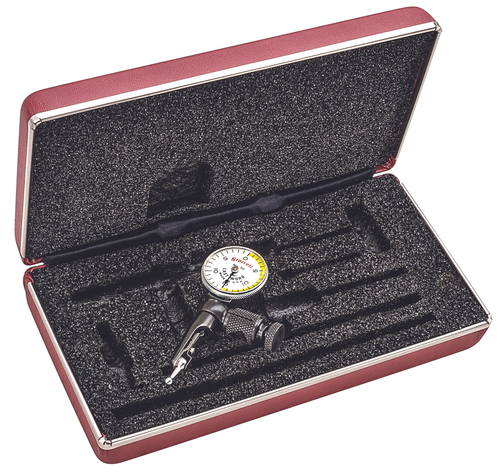

The venerable Last Word Dial Test Indicator is among the most versatile available
Their small size and variety of attachments will handle all jobs with ease and accuracy
A very useful feature is the shaded dial - when used with a mirror, in a jig bore application, the operator will always know the correct reading
Ideal for precise measurements in all machining, layout, and inspection work
Variety of attachments available to suit the application
Easy reading dials, half yellow for clarity
Hard chrome-plated ratchet contact point

The Starrett 711 Last Word Dial Test Indicator is among the most versatile available. Their small size and variety of attachments will handle all jobs with ease and accuracy. A very useful feature is the shaded dial - when used with a mirror, such as in a jig bore application, the operator will always know what the correct reading is. Indicator with univ. Shank, Body Clamp, Long/Short Arm.
The direct replacement is 711MGCSZ.
