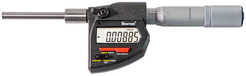

The Starrett W762.1XFL Wireless Micrometer Head with Standard Millimeter Graduations on Shell and Thimble includes 0-1"/0-25mm range, friction thimble, lock nut, and carbide face. Featuring large digital readout that is easy to read and reduces errors. Conventional inch or millimeter graduations are standard. Heads are easy to handle with smooth friction thimble for uniform pressure. 0-1" (0-25mm) Range, Friction Thimble, Lock Nut, Carbide Face. Free Mobile Application To use the wireless feature, download the free Datasure Mobile application from i-Tunes (iOS) or Play Store (Android devices). Your wireless Starrett tool will communicate to your mobile device from a distance of up to 30 feet. Send the data with the click of a button or your Starrett wireless gage. It is automatically collected on your device, and can be emailed. air-dropped or texted. The datasure app also provides lots of features and functions such as digital read out (DRO), formulas, unit conversions (SAE/mm), ability to name tools (connect 5 to 8 tools depending your on device capability), name parts being measured, set min/max levels, use device as a remote display, and much more. Download the brochure or give us a call for more details!

- Wireless operating distance up to 9 meters (30 feet)
- Rechargeable battery port
- Starrett no-glare satin chrome finish on thimble and sleeve
- Large, easy-to-read .275 (7mm) high contrast LCD digital readout
- Auto Off after 20 minutes of nonuse
- Inch/millimeter conversion on English versions
- Smooth friction thimble for uniform pressure
- Feature 09:
- Measurement HOLD button
- Feature 10:
- Zero at any position
- Feature 11:
- Retain and return to true zero reading
- Feature 12:
- Spindle lock
- Feature 13:
- Ability to install minimum and maximum limits
- Feature 14:
- Resolution: .00005" (0.001mm)
- Feature 15:
- Accuracy +/-.0001 (+/-.002mm)
- Feature 16:
- PRESET button to install any reading at any position
